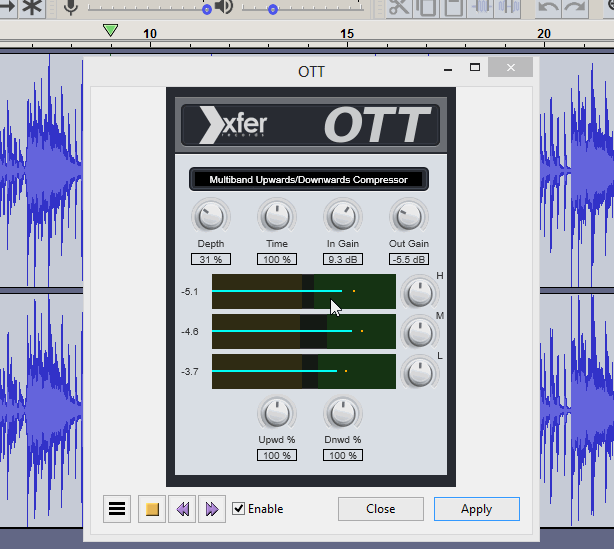

Unlike many native Audacity effects,
you can adjust OTT/KSHMR while the audio is playing and listen to the consequences of the changes.
The name of some of the KSHMR controls are cryptic …
KSHMR sub = sub-bass (<100Hz).
KSHMR Mid = bass , 100 = null.
KSHMR Trans = transient = punch.
KSHMR pressure = multiband compression.
KSHMR comp = single band compression (if you want pumping bass).
OTT’s depth is the amount of compression, (IMO don’t go above 50%).
A side-effect of compression (OTT/KSHMR) is that it reduces the stereo width,
so you may have to use dimension-expander afterwards to compensate.
[Alternatively KSHMR has a (stereo) width control which can widen if >100].
