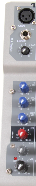

My mixer won’t work because my Effects Send for each channel is Post Fade. Once I pull the channel faders down (or turn them off), that’s the end of the special headphone feed. See illustration red knobs.
Is your AUX Send pre-fade or post-fade? If it’s pre, then that’s how you prepare the headphone mix. If it’s post, you’re in the same boat I am.
I think you’re in luck. The Top yellow knob in each channel, AUX Send, appears to be pre-fade. So connect all your inputs to the mixer as if they were real sources for the show including the computer. Mix the show going back to the computer normally but leave the computer channel turned down.
Bring up the AUX Sends on everything you want to listen to at once, this time including the computer. Listen to the AUX Send 1 connection. If it’s not loud enough and you run out of yellow knob range, then you’ll have to amplify it with an external headphone amplifier.
It’s possible your mixer allows headphone switching between Main and AUX. I can’t tell from the picture.
