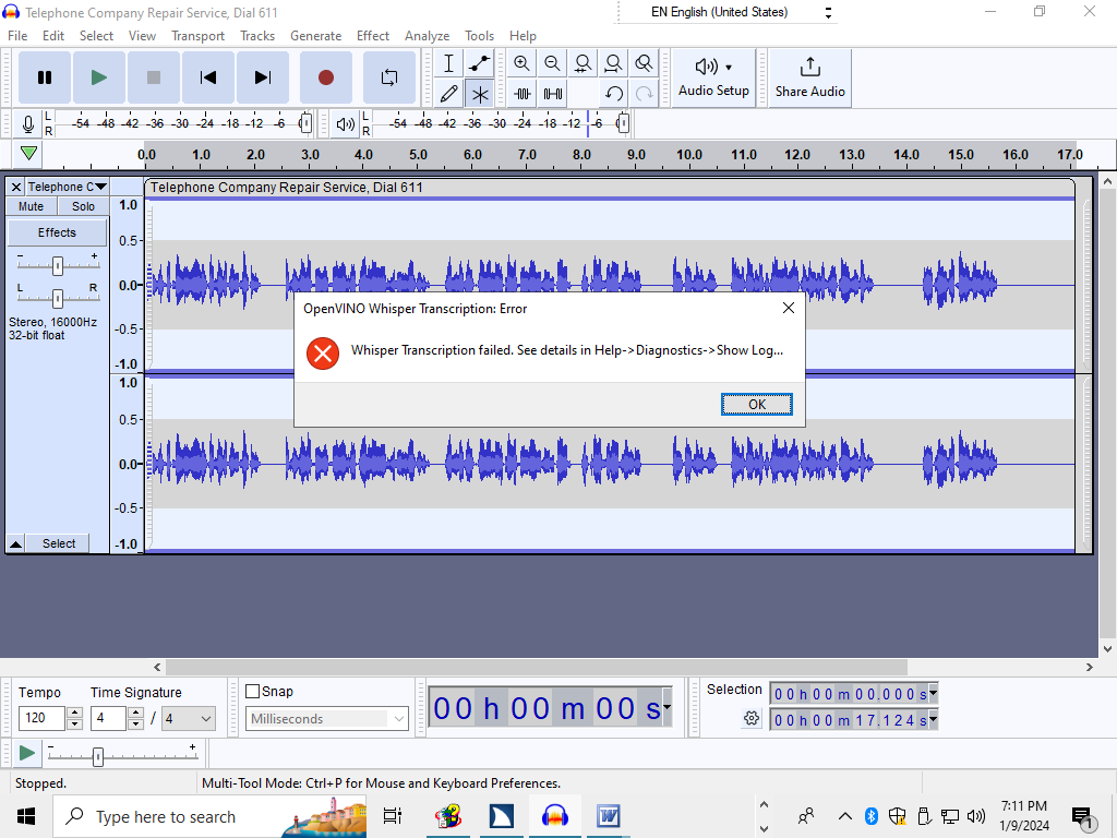

I’ve just now discovered some new AI plugins for Audacity. However, when I try them out, I get the error that the plugin fails. For what reason I’m not sure. Here’s the file I’m trying to transcribe with the “Whisper” model.
Maybe you’re using the wrong version of Audacity, or the wrong version of the OpenVino module, or you haven’t installed it correctly. See this page: Releases · intel/openvino-plugins-ai-audacity · GitHub
The version of Audacity I have is version 3.4.2.0.
Here’s what I got in the diagnostic log.

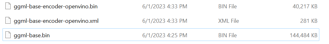

Hi @Annabelle3985,
Can you double check that C:\Program Files\Audacity\openvino-models
has the following files?
I’m afraid I don’t understand. The link you posted is an image, which my screenreader doesn’t know how to read. Screenreader software can only read text and text-based icons.
Ah okay. Without screenshot:
ggml-base-encoder-openvino.bin
ggml-base-encoder-openvino.xml
ggml-base.bin
Thanks,
Ryan
Yes, all three files are there. I wonder if one of them might be corrupted.
