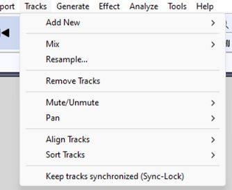

Here it is in Audacity …
https://manual.audacityteam.org/man/tracks_menu.html
Using “Tracks menu > Resample” will change the sample rate of the track.
The exported file will be at whatever sample rate is currently set as the “Project Rate” (lower left corner of the main Audacity window). The Project rate determines the sample rate of the exported file(s) regardless of the track’s sample rate.
