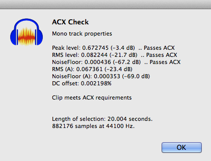

I used Mastering Suite 4 and added Noise Reduction 6, 6, 9.
This is highly not recommended because you applied corrections and then I applied corrections and Trebor has advanced different corrections yet.
This is the kind of thing that happens when the microphone and recording system isn’t up to scratch. The microphone has high volume frying noises and hum. It’s peaking the SS sounds in your words and may be uneven in it’s positive and negative waves.
The only up side is the volume (in the clip you posted) which is just about right.
If you’re using the built-in soundcard in your computer, I think I’m pretty safe in recommending you stop doing that. We can probably force this to work, but you will get a laundry list of different effects and corrections and you will need to be careful to apply them all to each and every chapter forever.
If you’re reading for audiobooks, ACX recommends strongly that all your chapters match, so there is no upgrading in the middle of a book or publication.

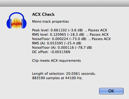

That is a centuries-old Zoom H4 sitting on a roll of paper towels (available at any Piggly Wiggley). The whole thing is perched on a furniture moving pad to avoid desk surface distortion.
You can get a nice Zoom H1n $120 usd which compares favorably in price to a Yeti USB microphone $150 usd. You’ll be missing the “Yeti Curse” and all the other computer and USB problems (skipping and stuttering) and the recorder will fit in your pocket.
Connect the recorder to your computer with a USB cable, transfer the sound files and master in Audacity.
If you do go the USB microphone route, remember you can never get more than 6 feet (2M) away from the computer.
Set up your paper towel and recorder and launch the script of your choice: Tablet (completely silent), Smartphone (completely silent) or (gasp) Paper.

I can’t see my sound meters while I’m performing. I could record at different spacing and volume, inspect the results and get close that way. I got lucky first time out.
I transferred my performance to the big Mac, shot it through AudioBook Mastering 4 and applied very gentle noise reduction of the beast (6, 6, 6). That’s what you’re listening to. I really sound like that. The obsessives will immediately correct the word timing just a bit and take out my congenital tongue smacks. I would not remove the breath sounds. I don’t know of ACX ever bouncing anybody for natural breathing sounds.
Do you know the product review trick? Ignore the reviews that say the unit will bake bread and cure cancer. Look at the negative reviews with a bad spelling or two. Those are probably real, especially if there are two or more that say about the same thing. Obviously ignore the reviews that hate the paint color.
I think the age of my recorder is showing in the voice quality. It’s mellow and pleasant to listen to. It does not have the modern “Professional Microphone” sharp, overly-crisp, harsh, annoying quality. Trebor notwithstanding, it probably doesn’t need DeEssing. Newer units may not be so lucky. I don’t know.
