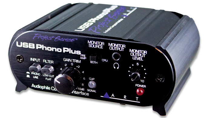

There is a much better one, the Art Phono Plus. It does have a volume control.
