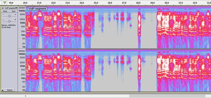

from 25 to 29 seconds there’s no recoverable voice except the Scottish man saying “yup” at 28seconds.

Ah, sorry this is just a very short clip of my guest speaking and responding to me, not the full audio (I have not shared my voice/track here) to give an example of the sound quality.
The ‘yup’ is just a response to me talking.
I am looking for advice on how I can improve the quality of the sound.
