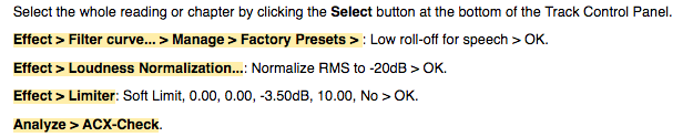

These tools do have a volume setting, so I found they work a lot better after Audiobook Mastering where the voice volume is stable and predictable.
If you do it that way and never change microphone or studio, DeEssing/Desibilating is a quick step at the end of mastering. The settings stick time after time. Effect > DeSibilating > OK. About that fast.

I tried that Audiobook process, and I gotta admit I’m not sure I like how that sounds.
