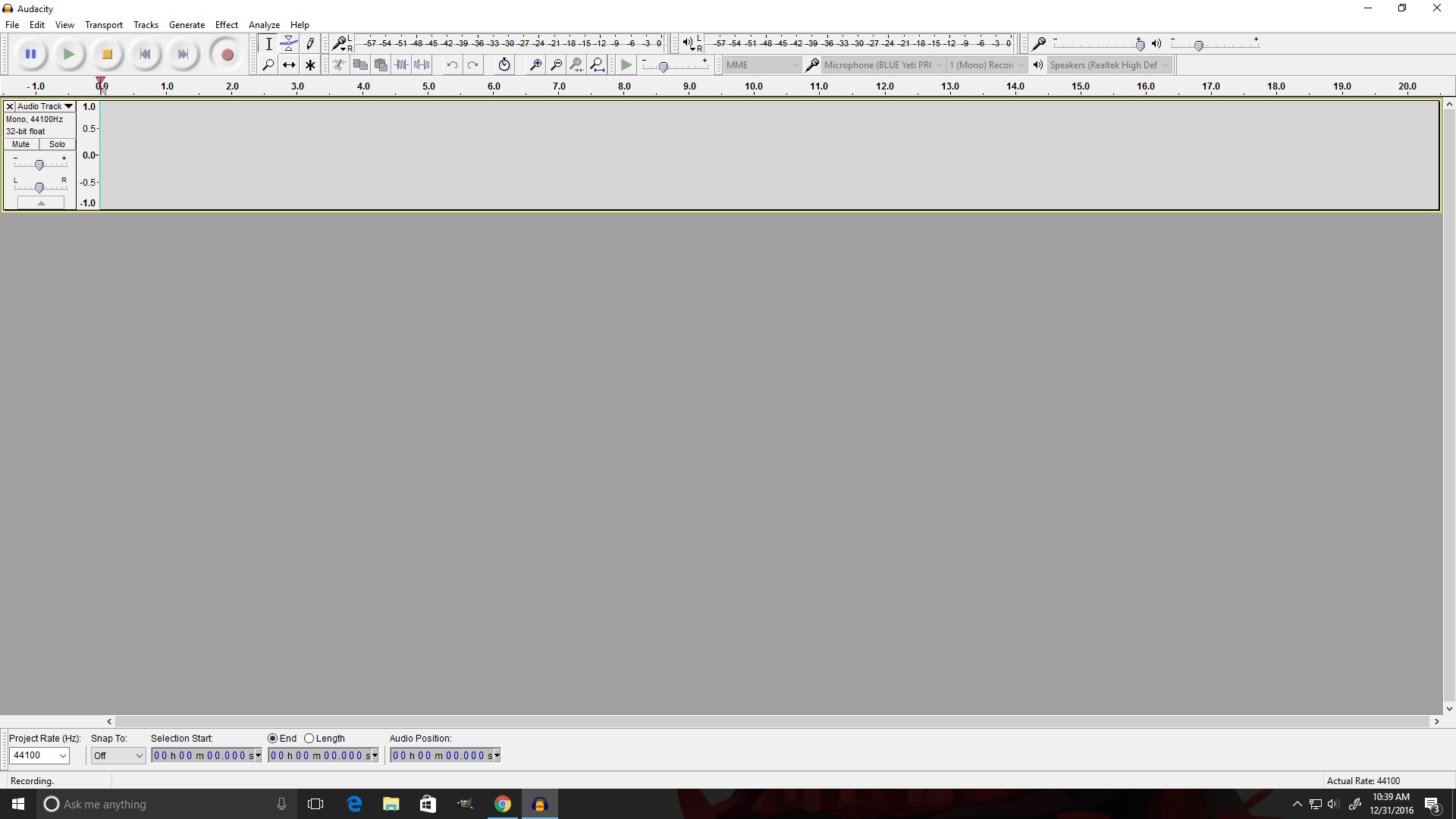

I’m using a blue yeti pro on windows 10, and when i hit record the timeline doesn’t move, and it doesnt record. the screenshot is literally what it looks like because nothing is moving. if i hit play after i stop recording, nothing happens. ![]()
Pull and replug both ends of the USB cable. When the connections settle down (the MUTE light comes on steady), restart Audacity. If still no joy, try setting Audacity for Stereo instead of Mono. The Yeti is a stereo microphone, or can be set that way.
i tried setting it to stereo, uninstalling/reinstalling the drivers, unplugging and replugging, and all that fun stuff. the line still doesn’t move.
Audacity does that when it fails to get data from the device. It’s odd because the Yeti has apparently announced itself OK.
