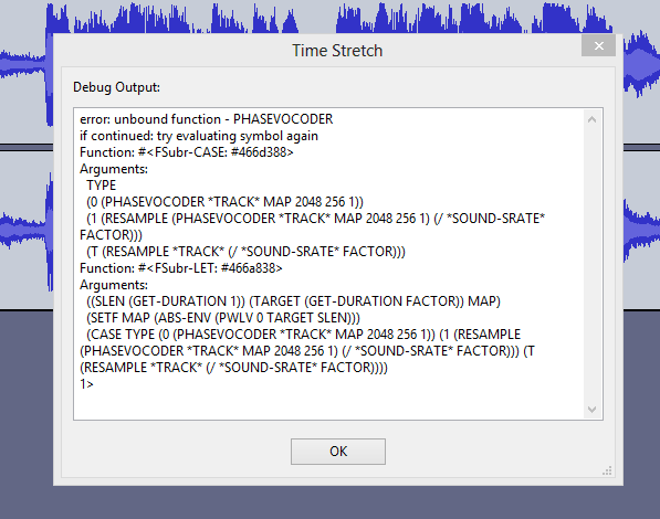

Works most of the time but intermittent problems (Audacity 3.0.4 , on W8)
Sometimes preview only working in right ear.
Sometimes Nyquist error …
Wow, that “unbound function” error is very strange. The PHASEVOCODER function is built into (recent) Nyquist - if it really was “unbound” (not defined) then the effect would never work.
I’ve reported the problem to Roger, so hopefully he will be able to locate the problem. My best guess at present is that there’s an uninitialised variable in the phasevocoder ‘C’ code causing an initialisation problem.
Your Time-Stretch plugin usually works …
Just checking - are you saying that both of those problems occur intermittently when using Audacity 3.0.4?
(the “unbound function” error is expected on versions of Audacity before 3.0.3)
Yes the problems were on the latest Audacity: 3.0.4.
[ I did not see any tell-tale pattern in the faults, but I only tried the plugin for a few minutes ].

The “unbound function - phasevocoder” error could be the result of something unrelated trashing the LISP heap in some way, so it would be interesting to know if other effects are working after this error is encountered.
