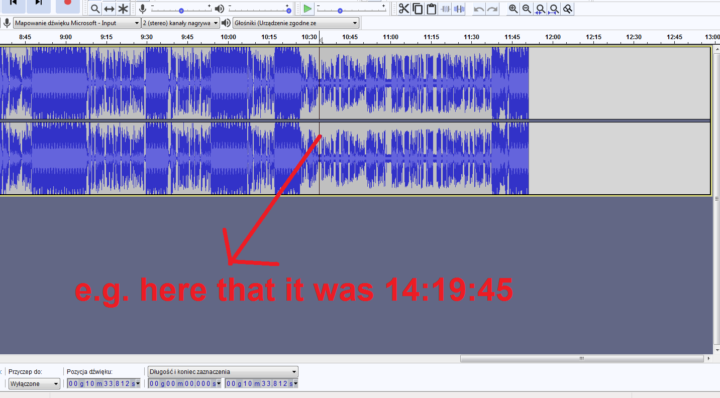

Is there an option in the program that the current time is displayed on the recorded track at a given moment? The point is that, for example, when recording something for a few hours, I would like to have a preview at a given point of the track at what time something was recorded. Of course there are methods to figure it out, but I’d like to make it easier.
There isn’t such a feature. Even if there was, it could only work for a new, unedited recording. For imported tracks there is no way to determine when the recording was made, and even for a new recording it would only work until you make the first edit.
