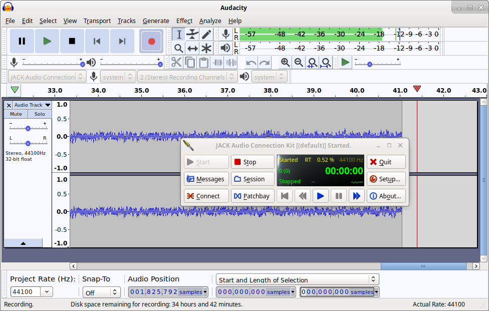

The most common problem when using Jack, is getting Jack to run with the selected device without xruns. Unfortunately, that’s something that we are not able to offer much help with as the settings vary from machine to machine. If Jack is not running reliably, or if there are any problems with Jack Audio System, you need to fix those problems first. Don’t bother even trying to use Audacity with Jack until you have the jack server running reliably.
Once Jack is running correctly, then using Audacity with jack is very simple. All you need to do is:
  1. Launch Audacity
  2. Ensure that “Jack Audio System” is selected as the “host” (see: https://manual.audacityteam.org/man/device_toolbar.html)
By default, the recording input and outputs in the Device Toolbar are set to “system”. The “system” input / outputs correspond to the inputs / outputs of the audio device that you configured when setting up Jack.
