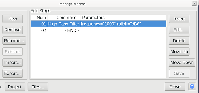

The macro “.txt” file must always be in English. Effect names will be displayed in the selected locale. For example, I have a macro containing:
High-passFilter:frequency="1000" rolloff="dB6"
When Audacity is set to English, the macro looks like this in the macro editor:

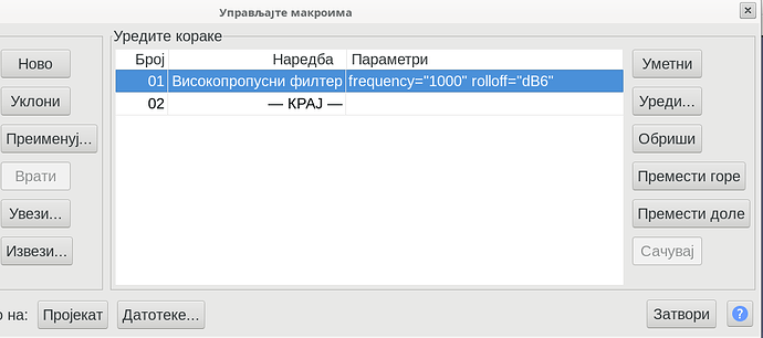

When Audacity is set to Serbian, the macro looks like this in the macro editor:

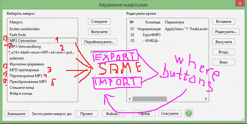

Yes, of course, I can quite imagine how multilingualism should work (I am a system programmer by education). But in practice, I watch some bugs with Cyrillic (Russian, Ukrainian, Serbian and other same) languages on my system (read pictures comments):
So far I consider it a bug of the program.
Perhaps this is a local problem on my system. Perhaps I am observing some kind of conflict of programs or libraries. Since, on top of everything else, other bugs have appeared - the export and import macro buttons have disappeared (When switching languages in the program settings, for some reason, the built-in macros are cloned (the picture shows as many as 5 export commands to MP3 in different languages), sometimes the track speed change command does not work correctly…
