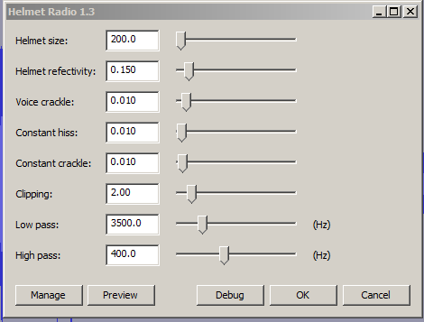

Here’s one I made earlier
[ If you want cell/mobile phoney-phone, export a copy of the audio in AMR format, (IMO use lowest AMR rate: 4.75kbps) ].

My “Helmet radio” plugin also does a good analog-phone impersonation
If you need that LPC touch of a modern cell-phone, saving a copy in AMR format can add that.
