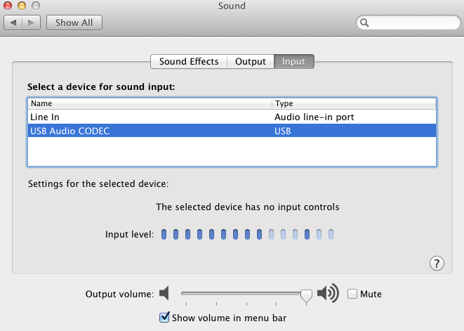

I have a Mac Mini running OS 10.7.5 and Audacity 2.0.3. I just bought a TEAC TN300 USB Turntable but I cannot get Audacity to “hear” the sound coming from the turntable. The turntable is plugged directly into the Mac via USB and the Mac is hooked into an Onkyo receiver and played through the CABL/SAT input. When I play anything that comes from the computer itself, like a video on Youtube, the sound works fine.In the System Preferences/Sound/Input I can see the sound coming from the turntable on the Input Level scale but I can’t get a signal into Audacity no matter what I set the input to nor can I get sound via the CABL/SAT input. Any ideas?

I downloaded the newest version of Audacity. Even though I’m getting a meter reading in the Mini’s Settings/Sound window, still nothing in Audacity and no output through my speakers. I’ve tried both the headphones port and the USB Audio Codec options, still nothing. Could it be my codec?

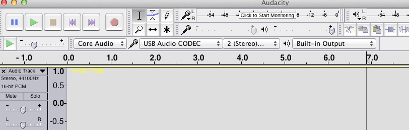

Here are my Audacity settings - I’ve tried every combination…

There is only one pair of settings that will work - USB Audio CODEC as the Audacity recording device
and Built-in output as Audacity playback device. Connect the turntable before you launch Audacity.
Software Playthrough should work if you press the Red record button. If you want to hear without recording, then as well as enabling software playthrough in Audacity, you must click in the Recording Meter:
so that it no longer says “Click to Start Monitoring”.
If Software Playthrough does not work, try LineIn from http://www.rogueamoeba.com/freebies/.
