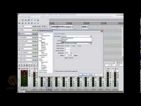

Thank you for these resources. Unfortunately, I think I’m gonna have to relegate Audacity for 2 trk or less. Looks like it’s impossible to get it to do more than that unless you have a certain interface/ mixer and are willing to do certain ASIO “hacks”. Just downloaded Reaper and I’m almost there. Something isn’t communicating quite right between the Tascam and the program just yet, but I’m getting there!
