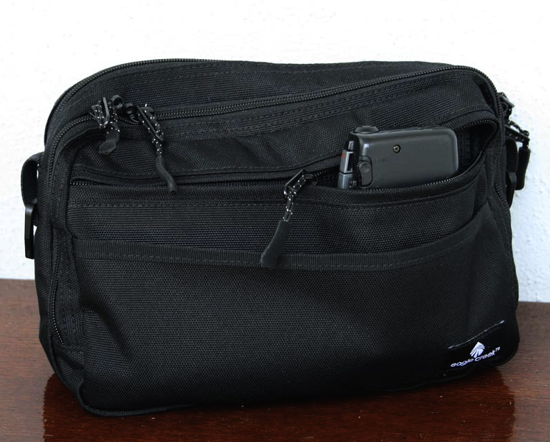

At the risk of being totally sacrilegious, here, did you actually compare them? I just recently found a solid-state Personal Recorder which could do a better job than my Olympus Micro-Cassette Pearlcorder.
Besides having decades experience with moving tape, they also had world-class quiet microphone preamplifiers and auto-gain processing. I took all of this for granted, of course. All I knew was I pushed the button and good recordings came out. Not always in High Quality Tape setting, either.
