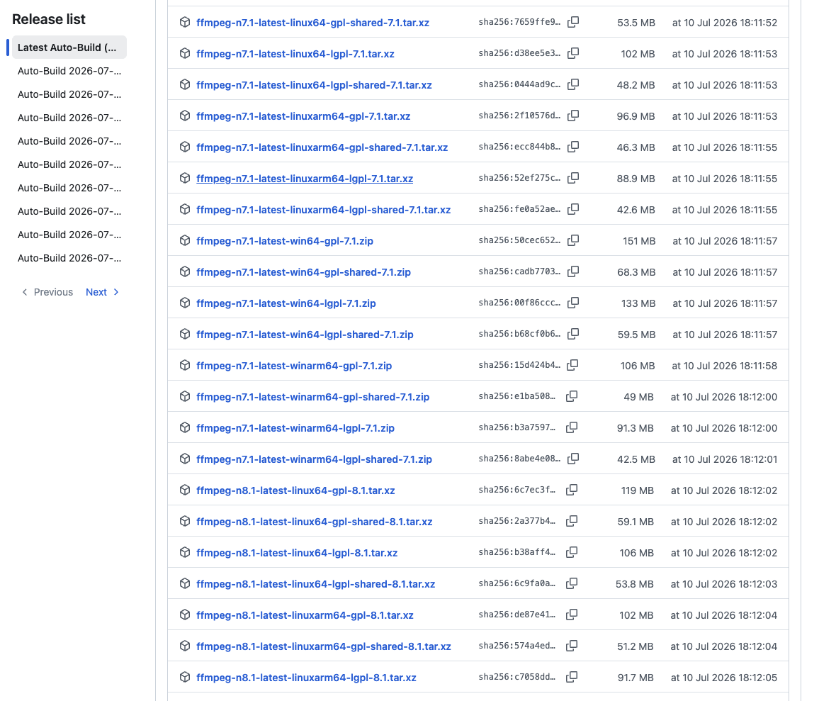

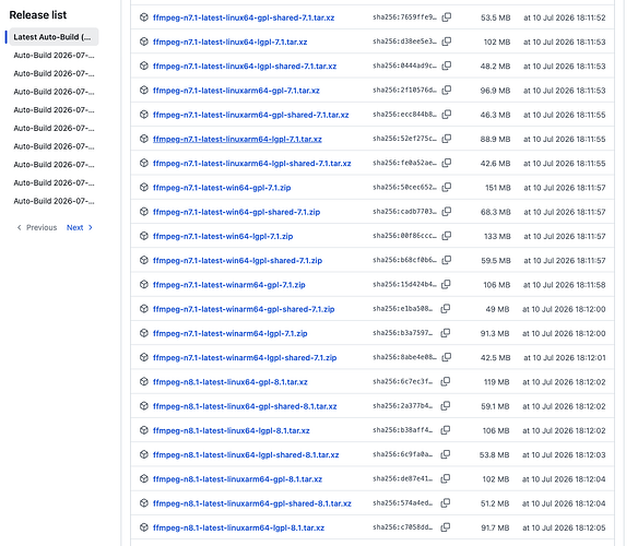

@bege please use ffmpeg-n7.1 or ffmpeg-n8.1 archive from Releases · BtbN/FFmpeg-Builds · GitHub .
Master version is not supported because its API is subject to change.
