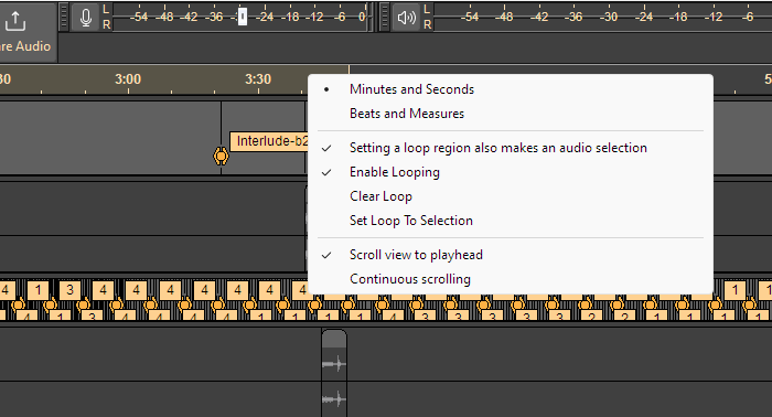

You can enable the option (in the Time Line right click menu) “Setting a loop region also makes an audio selection”. This ensures that at the time that you create, or adjust the loop region, the selection matches the loop region.
So that you don’t lose the selection, you can add a temporary label (“Ctrl + B”, then “Enter”).

To extend a selection to all tracks, press “Ctrl + Shift + K”, or from themenu
“Select menu > Tracks > In all tracks”
