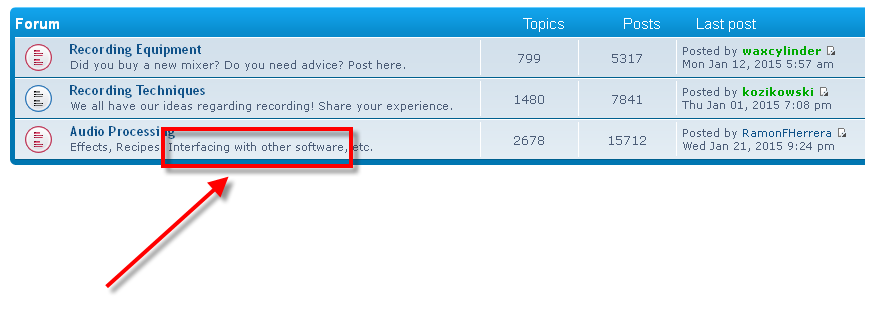

That is untrue. I respectfully requested that you “desist from misguiding other forum users”.
This is the post where I wrote that: How to remove snare drum ring from a recording? - #19 by steve
Let’s allow the readers be the judges:
In this particular post, a participant (johnrichki) was looking for a specific solution, right? Other posters joined the request.
(a) You provided 0% of what the user needed.
(b) I provided 100% of what the user needed (the “Audio DiffMaker” application)
… and yet I am the one who should keep his mouth shut?
