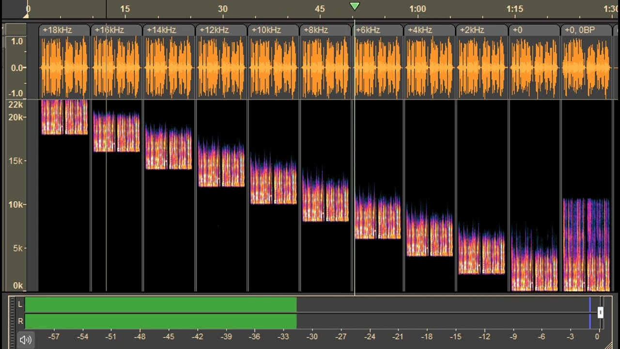

Hi, how are you? I’m from Argentina. I just installed the “Subliminal.ny” plugin by Steve Dalton. I wanted to know what parameters I need to modify so that the plugin works but using a “low” carrier frequency, so it’s not audible. Because when I listen with the original parameters, I feel a pressure in my ear. As if my eardrum is straining, and I find it quite uncomfortable. Thanks!

Thanks, DVDdoug. I’m a bit of a newbie :slight_smile: Why can’t the Subliminal plugin be used with a very low carrier frequency instead of a very high one?
The whole idea is to “shift” the frequency up, beyond he normal hearing range (1) so you can’t hear it. As Trebor says, lowering the frequency would make it more audible. (Less subliminal?)

I understand what you’re saying, but what I don’t understand is why, instead of “raising,” you can’t “lower” the frequency beyond the normal hearing range, so you can’t hear it. Wouldn’t that be the same thing?
Thanks for the explanations! Specifically, what I want to ask is why, instead of taking the carrier frequency to 16000Hz, as shown in the plugin parameter, I can’t take it to a lower range like 30 or 40Hz, so that it is not audible to me and is silent, fulfilling the subliminal function.
The minimum bandwidth for understandable speech is ~4000Hz. Cannot fit 4000 into 40.
The problem is range… You need about a 5000Hz range for speech (maybe 500-5000kHz) and you can’t squeeze all that below 20Hz. Plus, most woofers/subwoofers don’t go below the audio range.
