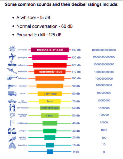

Ok now how would I make the music ie the foreground 20 decibels above the subliminal affirmations which should barely be able to be heard if the foreground is 20 decibels above the hidden subliminal affirmations that being the case at what decibels should the affirmations be and how would I accomplish this
I wonder if we’re just talking past each other. There are positive dB values. They’re Sound Pressure Levels or SPL.
Real world things are measured in dB-SPL. Planes taking off, cars driving by, orchestras, discos, etc. Zero dB-SPL in this case is sound so quiet nobody can hear it. Sounds work up from there in positive values. Massive explosions can have a valid dB-SPL value.
Those three sentences at the top have simple dashes, they do not indicate negative values. That was an unfortunate choice of English composition.
There are no direct relationships between the negative electronic numbers and the free-air positive numbers. If you are trying to work in dB-SPL, then it’s would be terrifically handy to have an SPL sound meter.

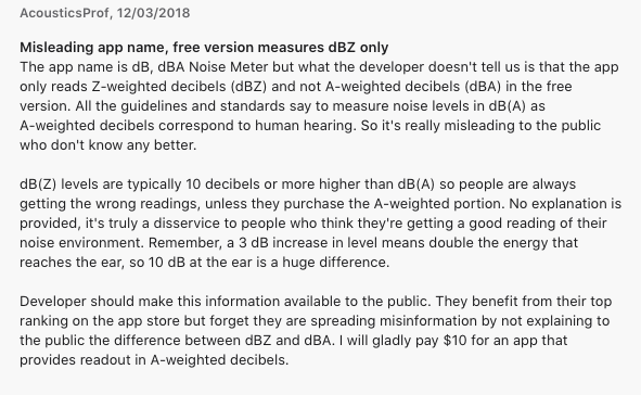

There is at least one Sound Pressure Level meter app for an iPhone.
https://apps.apple.com/us/app/decibel-x-db-sound-level-meter/id448155923
But it does come with a warning.
For brief explanation, dB(z) is the one that really does measure everything from earthquake waves and thunder at the low end to bat mating calls, dolphins, and hummingbirds at the high.
