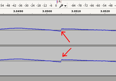

You do not appear to have any problems with DC offset, so no worries with that. The problem is with the exact position that you start and end your edits. In this close up from your file, you can see where the edit was made and you can see that the wave jumps suddenly upward as it moves across the edit boundary.

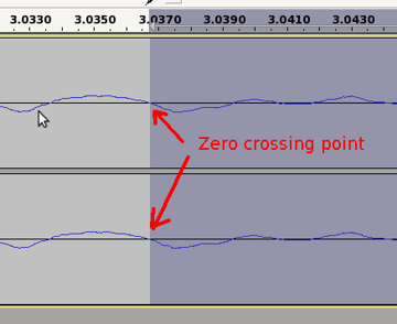

To avoid this from happening, you need to make sure that your edit points occur where the waveform is close to the centre line. This is called a “zero crossing point”. An example is shown below.

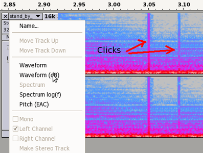

Sometimes there may not be a zero crossing point available that is close enough to where you make the edit (most often happens with stereo recordings) in which case you will need to repair the click. To do this, zoom in very close on the click and use the “Repair” effect.
Switching to the “spectrum” view can make it easier to find where the click is. Click on the little arrow next to the track name to select the spectrum view. In the picture below you can clearly see the click shown in the first image as it shows up as a vertical line:

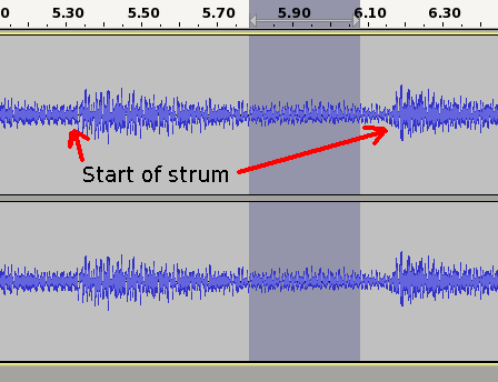

If you are cutting bits out from your recording, or pasting bits in, then making the selection so that it goes up to the start of a strum will help to hide the join. Let’s say that we want to make one note a bit shorter:
