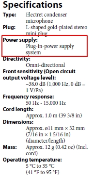

I found multiple hits that claim this microphone is onmidirectional but not stereo. I suspect the other ad postings are just parroting each other.
If by Plug-In Power they mean 5v on the ring, then most computers provide that at the pink Mic-In socket. What many computers don’t have is the ability to manage sound on the ring in addition to the Power. That’s unusual. Those sound cards are celebrities. It’s possible you can load drivers to get around that, but i have my doubts. Either the socket is wired with an extra microphone amplifier for stereo or it’s not.
Plug-In power is similar to phantom power in that the DC (typically 2.3 - 5V) is carried on the same connector the audio goes through.
