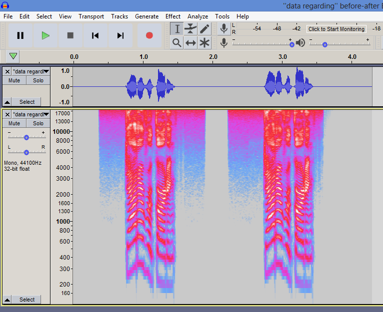

I can’t hear any beeps either, but there is a buzzy resonance at 7.4kHz & 12kHz,
which can be reduced by equalization …
