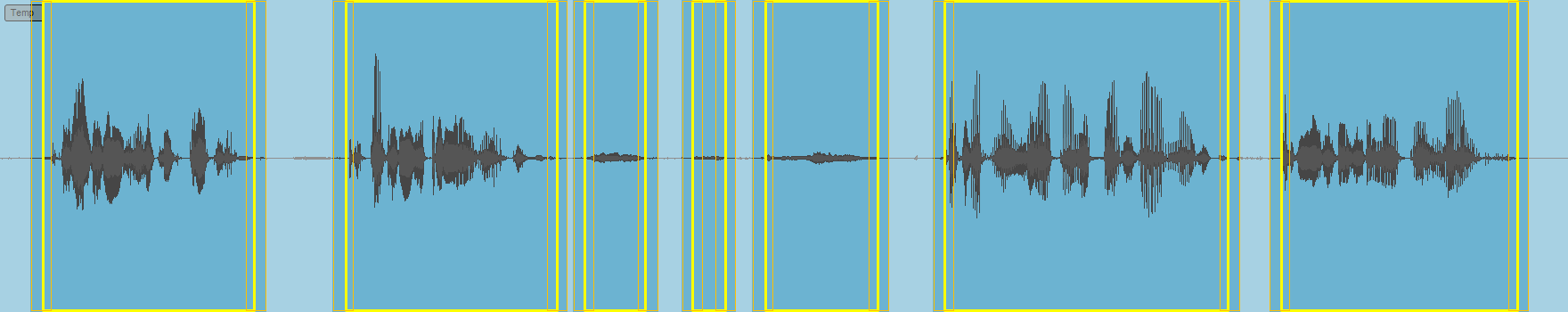

Yes, there is Attack/Decay and I dit a lot of testing to work only with this option, but there is a huge limitation. Maybe the following drawings show clearly the difference between Attack/Decay and Start/End Pad:
yellow=part of audio above threshold
orange=Attack/Decay
green=Start/End Pad
light-blue=audio reduced by gate (by set amount of dB)
Noise Gate without Start/End Pad:
Because I do not want to cut end of sentences, I must set threshold lower. But it means that a lot of noises are above threshold, so Level reduction is not applied on them.
Noise Gate with Start/End Pad:
With Start/End pads I can set higher threshold, because now I have extra space before and after yellow boxes that is preserved (green boxes), so Noise Gate will not touch the ends of sentences, but it will suppress much more unwanted noises.
Thank you.
Your first image is not quite right. The orange region should be outside of the yellow region.

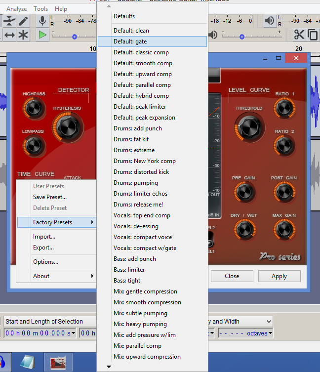

“JB Phatt Pro” is a free compressor/expander/gate plugin that works in Audacity on Windows …
IMO most of the old JB (Jeroen Breebaart) plugins are worth having …
https://web.archive.org/web/20130329211641/www.jeroenbreebaart.com/audio_vst_jb.htm
That looks like a nice plug-in with lots of knobs to twiddle. I guess that the side chain does not work in Audacity (?)
It has >30 factory presets for those unfamiliar with what the knobs do …
No, but everything else works.
