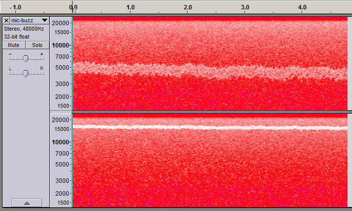

It’s a mono microphone , but the noise not the same on each channel :
there’s a ~5kHz tone on the left channel and a ~15kHz [harmonic] on the right …
Correct, but they’re very low level you could go a long time before you even notice them. Neither of those is the loud buzzing noise in the complaint.
If I crank up the volume I can hear the ~5kHz noise : it’s similar to FM-radio interference …

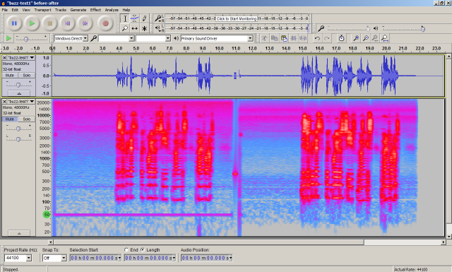

There is a faint constant 50Hz buzz on that …
50Hz buzz is from mains electricity, it can be intermittent : depending on the location of the microphone-wire & the position of your body.
The 50Hz constant tone can be quickly removed with Audacity’s notch filter.
IMO the most objectionable thing about “buzz-test1” is not the buzz, but the lack of bass …
