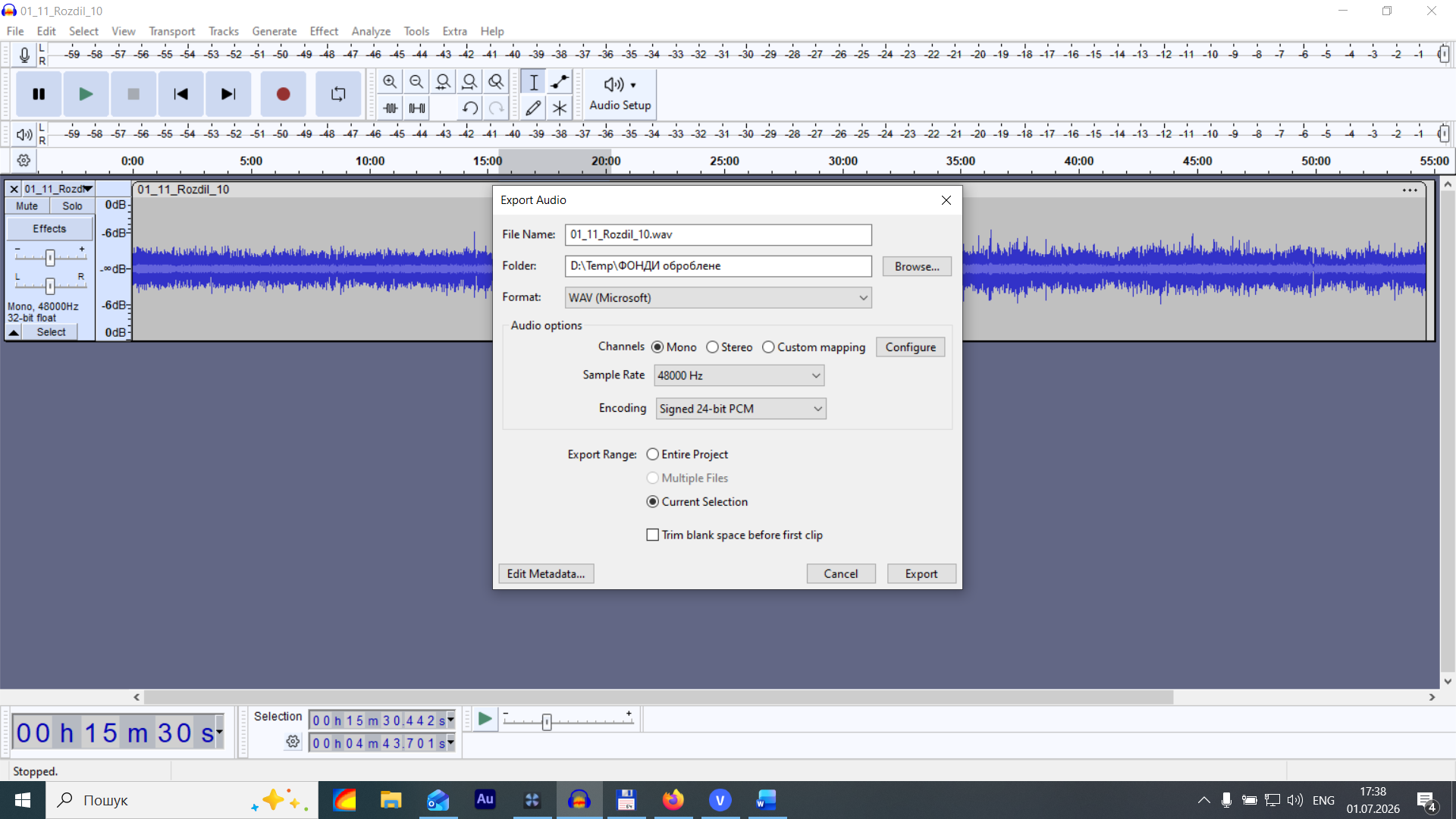

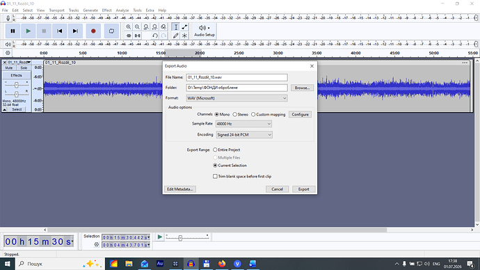

When exporting, choose ‘‘Current selection’’

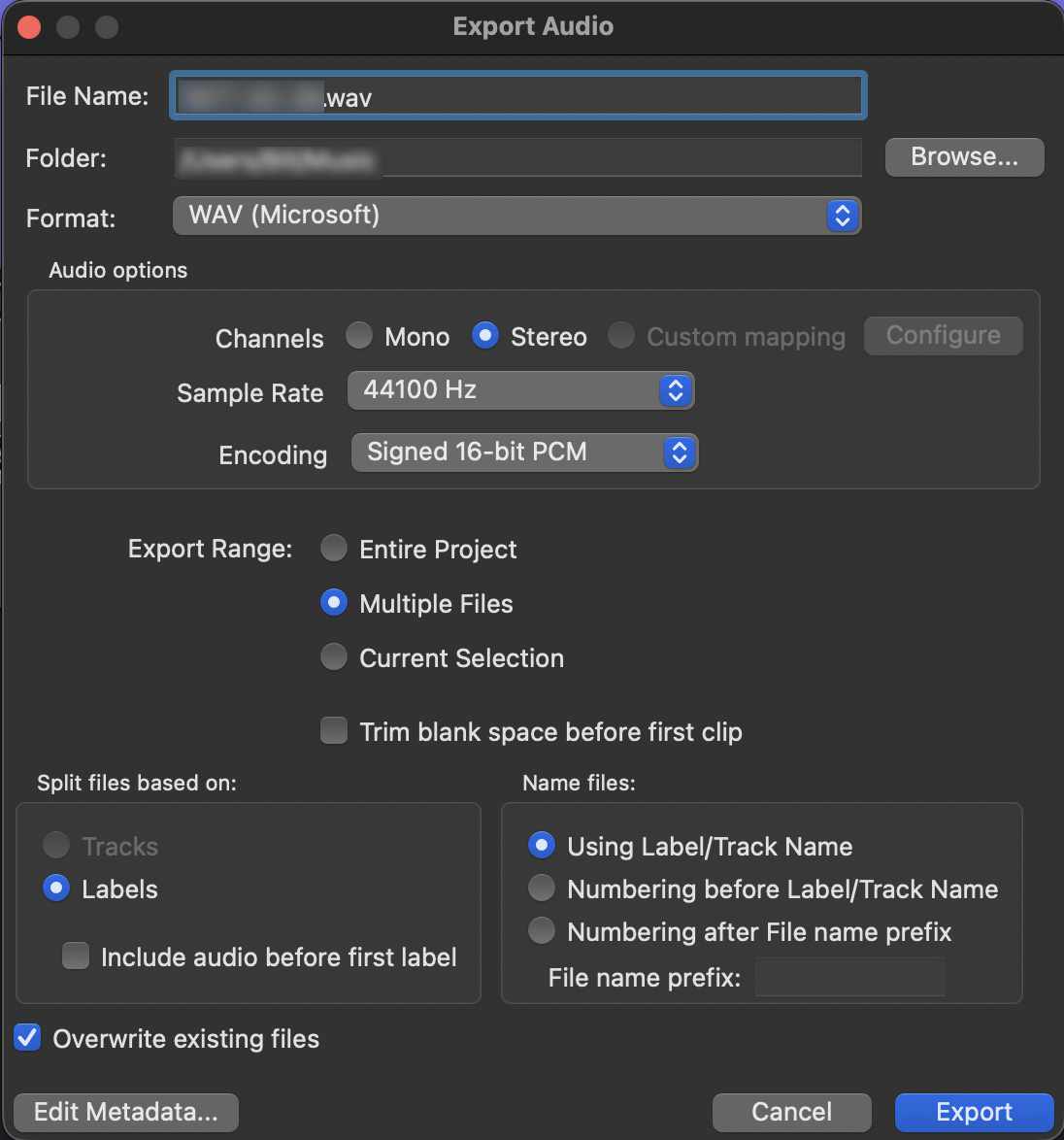

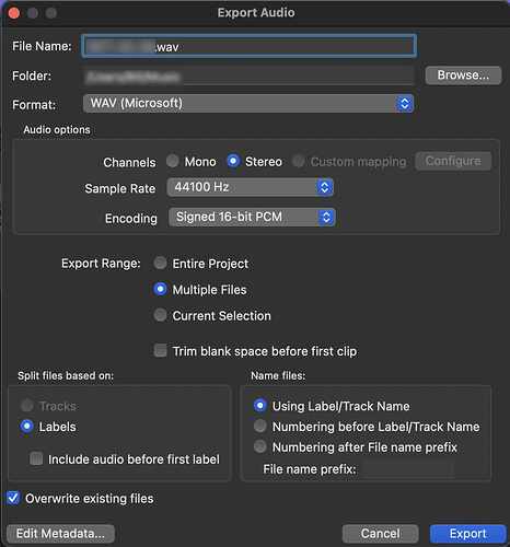

I think that screenshot is misleading/confusing. I don’t do it that way. I would select STEREO not mono and I would export ‘multiple files’ not ‘current selection’. This is what the manual suggests: Sample workflow for LPs.
Whenever Audacity opens/imports a file, it is converted into something Audacity can deal with. This is then not an audio file. You then need to export it (again) as an audio file, after you had labeled the individual tracks.
Thanks so much. That seems to be it.

Does your Export dialog look something like this?
