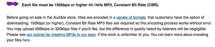

Are you submitting to ACX? ACX requires MP3 at super high 192 quality.
You can’t increase the quality of an MP3. Full stop.
If ElevenLabs delivers a 192 MP3, you can’t edit and make a 192 from that. If they deliver lower quality, you may really be stuck. This is from ACX.
This is a copy of their submission requirements.
https://help.acx.com/s/article/acx-audio-submission-requirements
