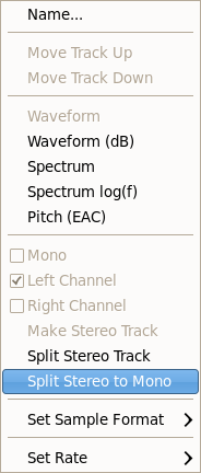

The result is this:
And it works :open_mouth:
