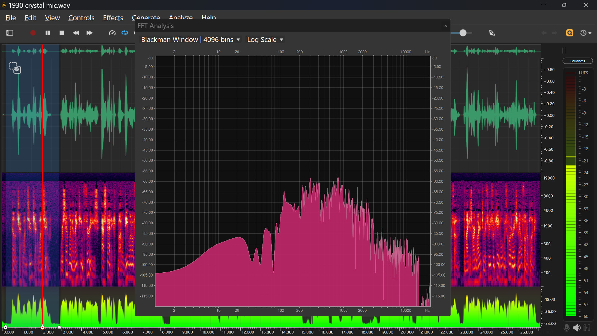

Other than the SPAN plugin, the only other free option I can think of is OCENaudio …
