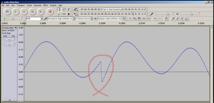

Short WAV file attached called “audio distortion.wav.” It is a simple scale on an electric piano.
That’s very strange. It sounds like it’s badly clipped/overloaded but the waveform isn’t clipped and there are lots of dynamics.

There’s audio chopped-out every 1/100th of a second …
Softwares can fight over who has control of the sound card,
that can cause consistent interruptions on that (10ms) timescale.

As Trebor wrote, there are discontinuities in the waveform, so the primary problem is not to do with Windows Enhancements.
That’s not a safe assumption because there are many ways (different APIs) for applications to communicate with an audio device. Because a sound card appears to work correctly in one application does not exclude the possibility of driver problems.
The type of error shown in your audio sample is often caused by driver problems, so you should check that your audio device drivers are correct and up to date. Don’t rely on the automatic Windows selection - that usually just selects generic drivers rather than drivers that are specifically designed for the hardware. If you computer is a laptop and you are using the built-in audio device, check the laptop manufacturer’s website for the most recent drivers for your laptop model and version of Windows.

Based on the instructions on the lenovo website, I uninstalled the sound driver and allowed it to re-install upon boot. That solved the noise problem. Now I have a new problem, for which I’ll open a new case: recording volume is VERY low.
