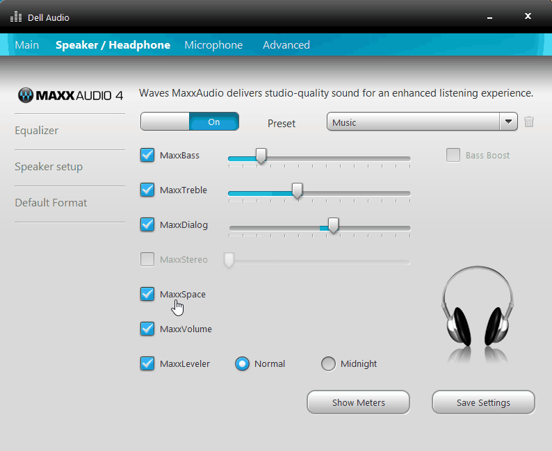

Windows audio (playback) enhancements* can introduce crosstalk between left & right …
Here’s how to turn them off … https://youtu.be/eXGyAzk3fd4?t=49
[ * there can be a second layer of audio enhancements provided by the computer manufacturer,
sometimes called MaxxAudio ].
