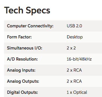

How do you connect them?
The UCA202 is big-connector USB-2. The UCA222 is USB1.1.

The settings seem to be quite similar to yours - left and right channel have the same volume setting, so there is no obvious reason why one channel would be acting different than the other. See attached image,
