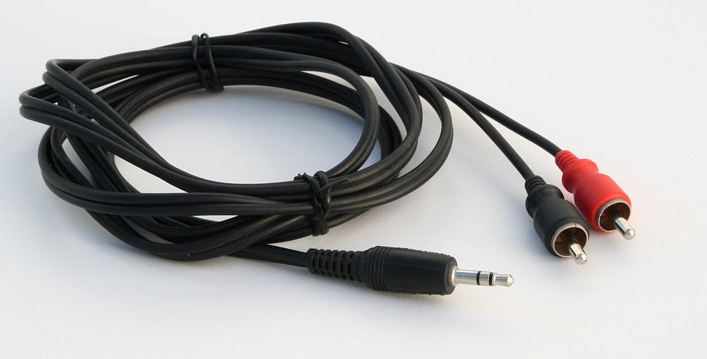

If it’s a full-on soundcard, you can just buy a straight interface cable and go into the Blue or Line-In connection.
http://kozco.com/tech/audacity/pix/RCAMiniStereo.jpg
