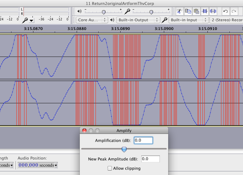

And here’s another audio mystery about clipping indicators in Audacity on a finished commercial release aiff file off a Thievery Corporation CD. See the screengrab below of clipped and top chopped kick bass notes and what Audacity’s Amplify suggests to do with the waveform which is nothing. But of course this song sounds great and very loud on my all my audio systems.
Listen to all the audio artifacts I’m assuming is caused by the clipping but doesn’t destroy my Polk 6x8’s in my sedan’s backdash…
