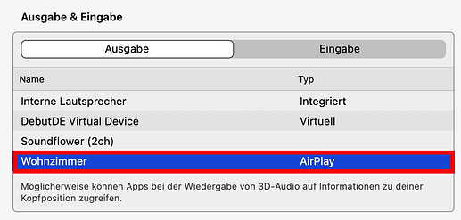

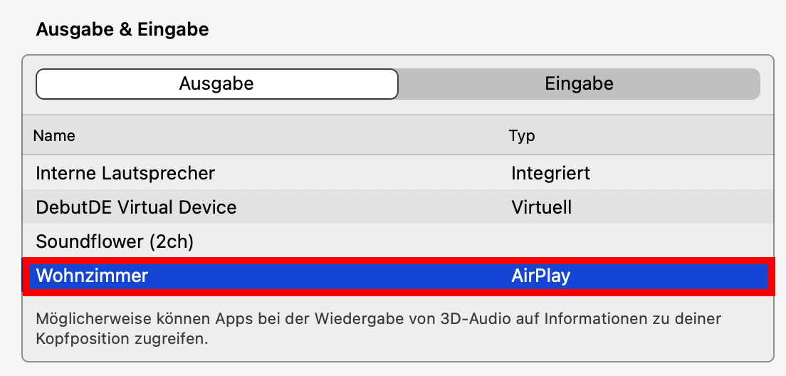

You can play your music (or whatever) in Audacity and hear it on your AirPlay-capable device. Just select that device for sound output in your System settings:
“Wohnzimmer” is an old Airport Express connected to my stereo equipment.

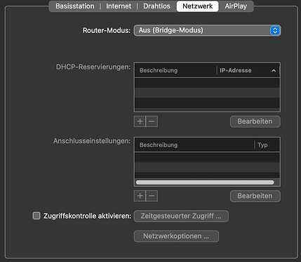

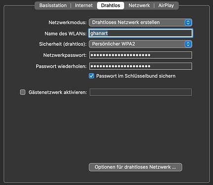

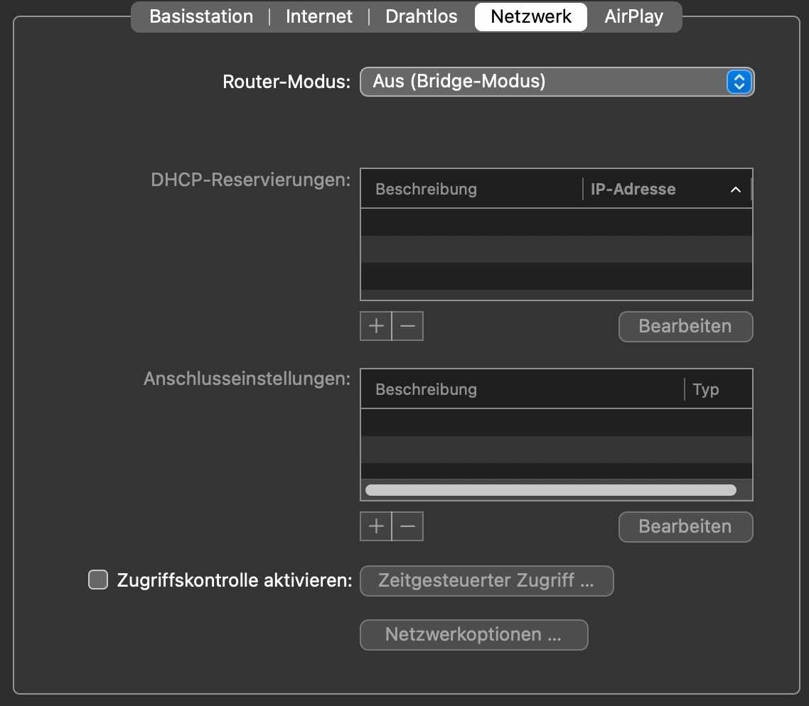

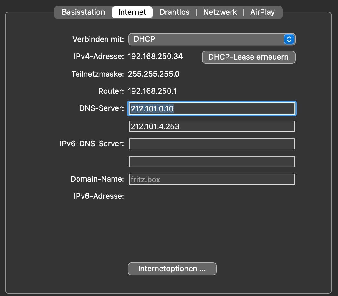

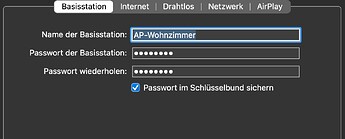

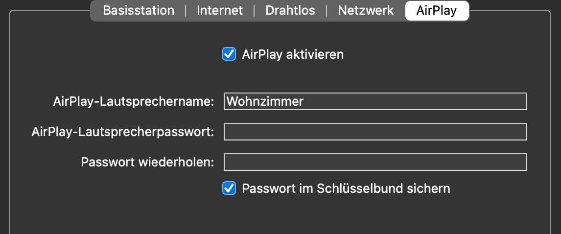

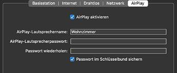

My Airport Express (AE) is connected with wires to my router (a Fritz!Box, but the router type doesn’t really make any difference). It should also be possible to configure the AE so that it gets the signal via WiFi.
The AE is set up for acting as an access point, not a router and not a repeater. At the end of this text I’ll post screenshots of the AE’s settings.
Apparently, the old AE (one of the 2nd generation, not the one that plugs directly into the wall socket) can be configured using the Airport Utility from macOS Sequoia - my other Airport (Airport Extreme, the round one) cannot… I need to use the Airport Utility 5.6.1 together with a launcher app, which is not so straight forward. The Windows version of Airport Utility 5.6.1 should also work on W10, I was told.
