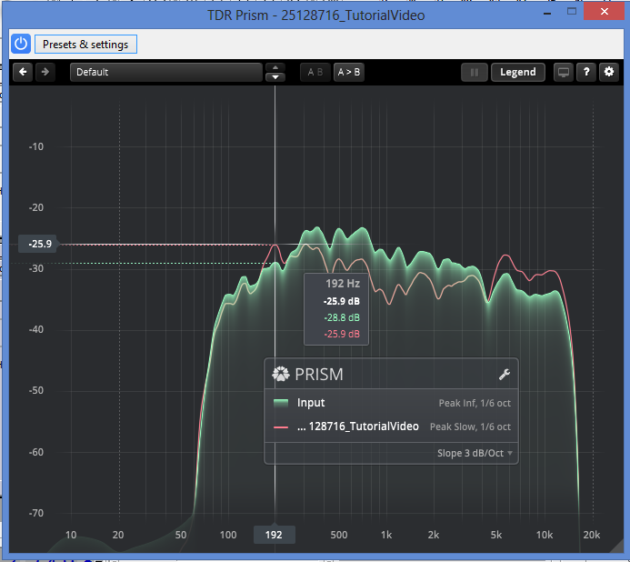

It’s fixable with dynamic EQ which attenuates that frequency when it exceeds a threshold
before-afters
I did this manually using the free version of TDR Nova, but the easiest way is to use a de-resonance plugin like Sonible’s pureEQ, (30 day free trial, ~$30 to buy).

Forgive me for maybe being dense but, is that bad? I was half expecting a long list of things to change, but would it being a bit too bassy be enough to put off potential buyers? The previous demo was flat with regards to EQ and I know that the curve I applied was adding a bit more bass for “oomph” but wasn’t aware it would be that much of a problem.
Today while searching through options, I had found a musefx plug in, which does have various eq filters to apply. I assume I should be able to apply a similar curve and just watch how much it boosts that the 190-200 frequency?
192 Hz is aresonant frequency of your recording booth.
When the pitch of your voice coincides with that frequency your booth rings.
That resonance is annoying if you had to listen to it for minutes:
imagine a tune played on keyboard where one note was much louder than all the others.
The resonance also reduces intelligibility.
