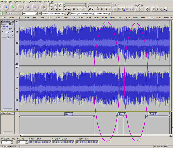

To me, it’s easier to note down the parts I do want to keep, select them, and have Audacity remove the rest:
At this point, I defined three regions… and am stuck at how to have Audacity remove the rest of the audio, ie. the parts between the regions. Neither the tutorials, Google, or YouTube helped :confused:
I don’t think there is any provision to do that. Delete “everything I don’t want” is dangerous. One wrong move and your show goes away. Isn’t there an “Invert Selection?” One of my editors can do that.
Labels became more important than you would think because particularly if you’re used to a video editor, Audacity doesn’t have edit markers. The only way to mark an action region is Labels.
It doesn’t matter: That’s what CTRL+Z is for.
Yes, I was looking for either a “Delete unselected parts”, or “Invert Selection” followed by “Delete selected parts”, but so far, nothing.
Surely, there must quite a few users like me who need to 1) select some parts they want to keep, and 2) have Audacity remove the rest of the audio.
I think the closest we get is File > Export Selection.
But File > Export selection would export each audio section, re-encoding the audio in the process, before having to re-combine the parts, and re-encoding them. Definitely not what I want.
Found a work-around:
  1. Launch a second instance of Audacity
  2. In the first instance, create regions for each segment you want to keep
  3. For each region: Select it by clicking on its label in the Label Track, select Edit > Copy, switch to the other instance of Audacity, select Edit > Paste
Maybe there’s a faster way, but it does the job.

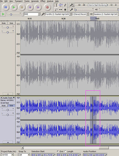

After adding a stereo audio track, I notice that hitting the End key jumps to the end of the imported audio track, even after making sure the focus is put on the new audio track: Is there a way to jump to the end of the new audio track instead?
“K” (Moves the cursor to the end of the selected track)
See: Audacity Manual

I’m stuck at how to crossfade the parts I copy/pasted from the full file above to the new audio tracks below:
Effect > Crossfade Tracks says “Nyquist: Only 1 track selected. ‘Crossfade Tracks’ requires 2 tracks.”
OTOH, although it looks like what I need, the Crossfade Clips article on the Audacity site contains no URL from which to download this plug-in.
Edit: clipfix.ny is listed in "c:\Program Files\Audacity\Plug-Ins", but Edit > Preferences seems to show no way to enable/disable plug-ins: Why is Crossfade Clip not listed in the Effect menu?
It is included in Audacity 2.1.1
