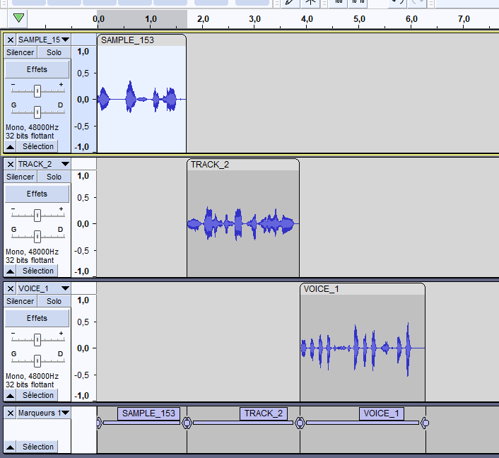

This is what I would like to achieve :

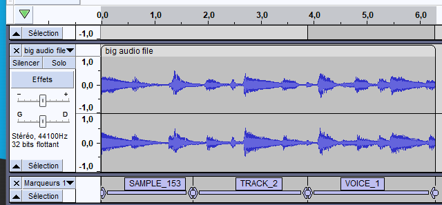

The result would look like this after I would have processed the big audio file, then I would just have to export multiple according to labels and it would be done :
aide audacity 2
And for this, I specifically need to generate the labels according to the tracks like I’ve showed in the 1st picture, but this I did manually. Is there a “generate labels from tracks” feature, or maybe a script ? I think this can be done by coding but this is way out of my skills.

What would solve my problem is a way to automatically set labels according to the tracks, each label named like the track it matches with (like picture in 1st post). I think it might be possible ?
