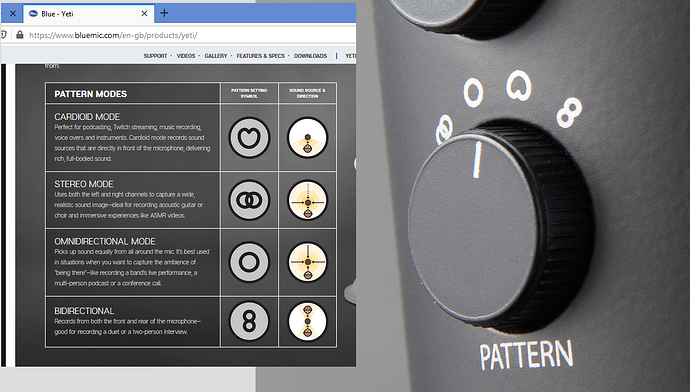

Blue Yeti has adjustable sensitivity patterns. IMO Cardioid & Bi-directional are wrong for ASMR …
https://blog.bluemic.com/youtube/how-to-make-asmr/
