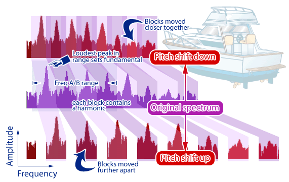

There is a free plugin called DtBlkFx, which uses FFT, which has two frequency-shift options,
one is “Const shift” which is “non-harmonic shifting by a fixed frequency”
DtBlkFx works in Audacity on Windows.
