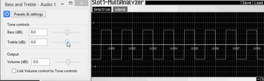

Simple Low & high pass filters reshape the waveform …
tone controls in 1kHz square

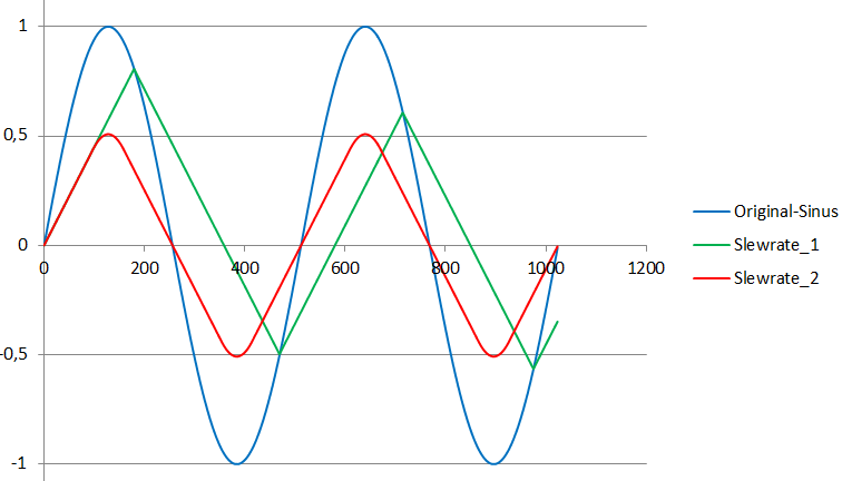

Hello, my intension is to get a slewrate function like the red one in the diagram. I simulated this with Excel. The difference to the snd-chase function is, that the actual slope is computed by the original signal only and not the green curve, made by the difference between the modified signal and original sample value (which is made by snd-chase).
By the way, do you know where the code is behind the snd-chase function?

Yes, I know this explanation. The function is clear for me: The output follows up the input as fast as it can, but limited by the slewrate defined by risetime and falltime. In most cases the output is formed to triangles. In my imagination I want to add the slopes from sample to sample to its last output values, where the slopes are limited by risetime and falltime. This results to much different signals, though.
