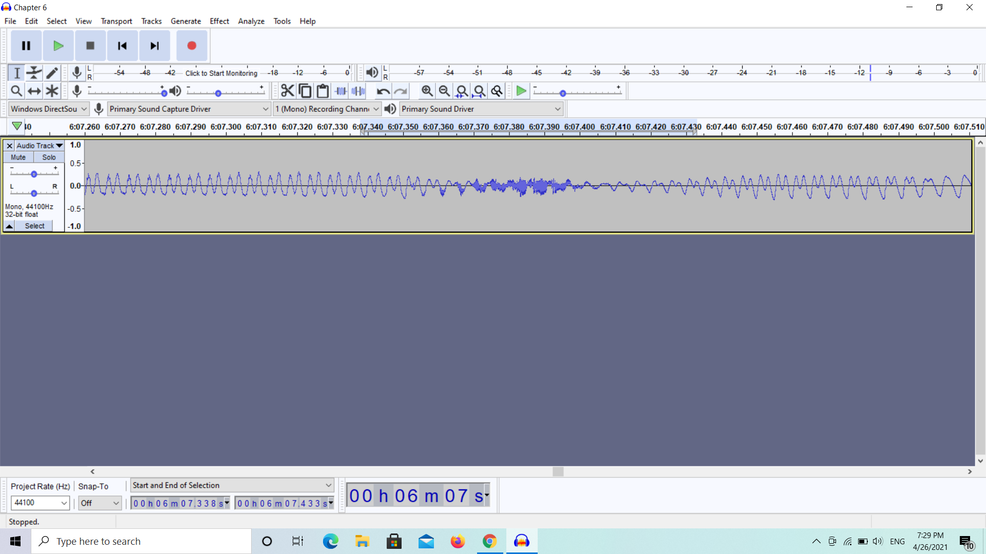

Here is another of these odd click sounds in the sound wave

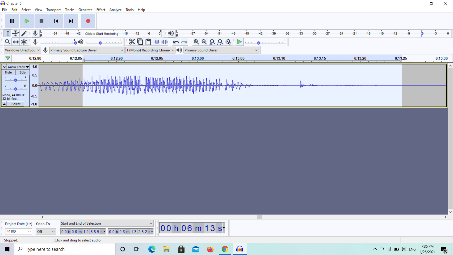

Here is another.

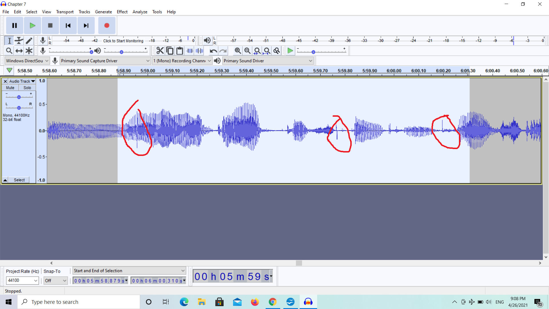

Just to make sure it wasn’t the new microphone stand, I changed back the old one. Once again about 5 minutes into my recording there are again these clicks or spikes in the wavelink.
What is even more frustrating is that I haven’t even figured a way to edit them out for a temporary solution so I can finish the project I am working on. Cutting them out leaves it sounding weird.
Here is another recording with some screen shots of my latest recording with the old microphone stand.
