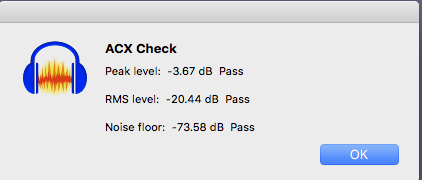

Here’s a sample of the new set up in a new house, new closet, with the relatively new mattress as acoustical treatment. The sound is quite clean I think–buzz is gone. I recorded in stereo to make up for the 2-input interface/6 dB reduction, but I fear that that is causing problems down the line.
The “no mastering” track hasn’t been mastered in any way, just simple edits and de-clicker, still only in one channel.
Problem is, when I run my ACX mastering chain (RMS norm at -22) and then create an mp3 with force-to-mono (the only way I know how to get the sound in both channels) the resulting mp3 is way too quiet. I’ve included the mp3 to show you what I’m talking about.

I do not understand what the problem is.
I mastered Track5_mastered_forced mono.mp3. It is, to quote Ms. Poppins, practically perfect in every way.
