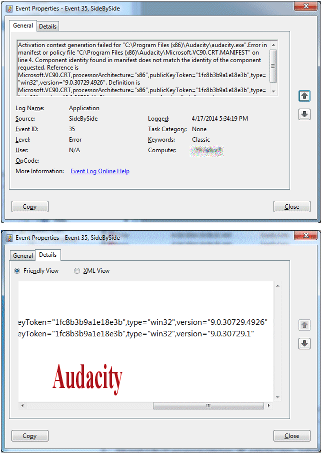

I’ve done quite a bit of investigating with the MicroSoft Event Viewer and have noticed that Audacity appears to be looking for a wholly different version of the Microsoft Visual C++ redistribute package. [see attached file]

I followed my Event Viewer error log as hints and edited the registry and made sure that “Microsoft.VC90.CRT.manifest” file was pointed to the matching version; 9.0.30729.1 in the HKEY_LOCAL_MACHINECOMPONENTSWinnersx86_policy.9.0.microsoft.vc90.crt_ key of the registry.

OK thanks for the support link. I did not know about that registry key, but all the “difficult” cases I’ve fixed for people have involved making the msvc* files and the Microsoft.VC90.CRT.manifest contents the same all over the computer. I wasn’t told it broke some other application, but of course it could do.
So are you saying you had to set the (Default) string value in that key to “9.0.30729.1” as per the Microsoft.VC90.CRT.manifest shipped with Audacity? I was a little sceptical because I only have one number in that key which is “9.0.30729.8387”, but I don’t have an issue with the Audacity release version.
That is correct. I changed the string value in that key to 9.0.30729.1. And, if I recall correctly, the string was at “0” when I first looked at it. And that would explain why Audacity and and a few other programs were no longer working.
