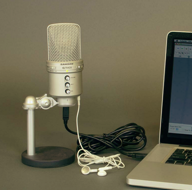

Couldn’t you hear the noises in the headphones?
You should have a good pair of wired headphones connected to your microphone or interface during production. You can’t connect them to the computer and you can’t use wireless headphones.
