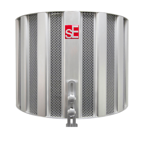

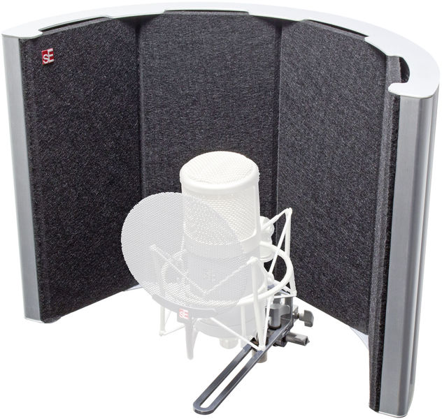

The main problem with “box” type portable booths is that they invariably sound “boxy”. There are thousands of articles on the Internet that say how easy it is to make a portable acoustic booth by putting the mic in a box and stuffing it with fluff, and go on to say how great it works, but in my experience that is just not true.
Even the best sound absorbent materials work only on a limited range of audio frequencies, and are never totally absorbent in any frequency range. Placing sound absorbent materials directly in contact with reflective materials (the box) reduces their effectiveness substantially, and any kind of rigid box will have resonant frequencies according to its size and shape.
Other types of acoustic shields are available that do work. They still won’t give good results in a room with terrible acoustics, but they can make a substantial improvement in a room with “reasonable but not great” acoustics. When used in conjunction with some heavy blankets, they can provide pretty good results in most quiet spaces, but they can’t do miracles - a bathroom will still sound like a bathroom.
Here’s an example of the type of acoustic shield that actually works and does not add significant amounts of colouration to the recorded sound:
The construction differs substantially from the box full of fluff in several ways:
- The outer skin is substantially “open” so that it does not bounce sound back into the mic
- Multi-layer construction to absorb a wide range of frequencies
- Combination of absorbers and diffusers to minimize sound reflections
- Highly quality materials greatly out-perform cheaper alternatives (and better durability).
- Carefully calculated proportions, thickness and spaces to “trap” lower frequencies.
- Sufficient distance from the mic to allow the mic to “breath”. Studio microphones are either open at the back, or “ported” to allow the diaphragm to move freely in response to the sound. Overly restricting the space around a microphone, even with sound absorbing materials, can produce detrimental changes to the microphone’s frequency response.
That’s why the semi-standalone booth works so well. Separated from the room’s walls, reflected sound has to go through four layers of moving blanket. Two going out and two coming back.
The Se unit looks like a very good deal, but you should also remember that the microphone, given a gentle cardioid directional pattern, is aimed at you…and the wall behind you.
What he said.
I had purchased a SE-RFX face shield for around $139.00 and it works great. 6 days later, I saw a Woman that spent $27.00 for a piece of Acoustic Foam. She tied a string to the top and bottom, making about a 300 degree circle, with her Snowball mic sitting in the center. She sounds like she is sitting in a million dollar studio. ![]()
If the room already has pretty good acoustics, that may be all that is necessary (and it’s likely to be a lot better than a box stuffed with fluff).
