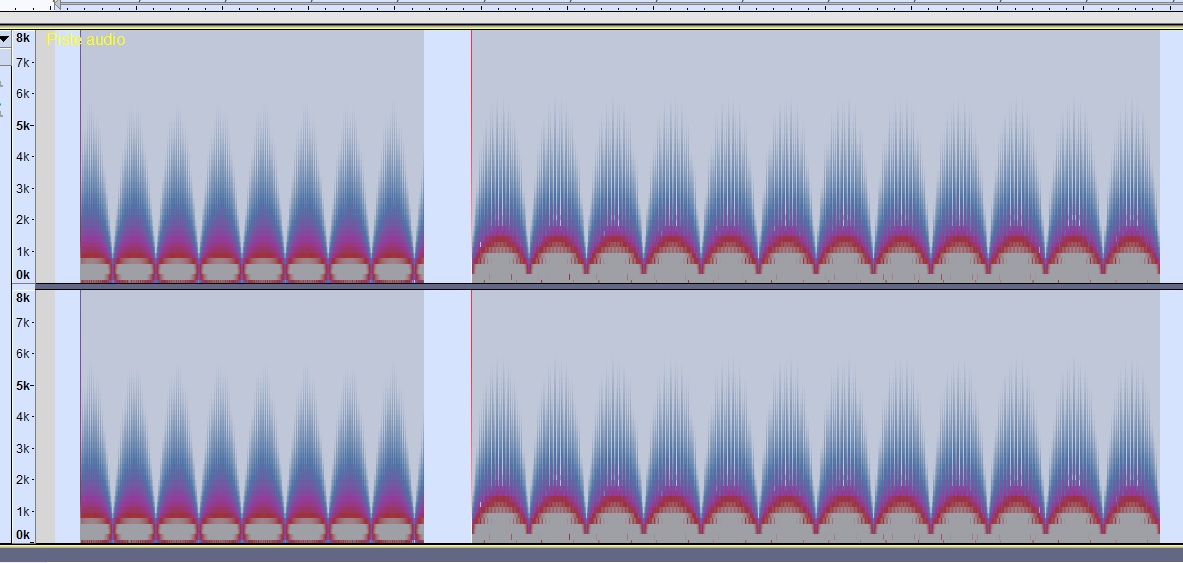

But, look at this code:
(defun mytone ()
(amosc (hz-to-step 195.997) (hzosc 1.5)))
(defun envshaper ()
(mult (sum 1 (hzosc (const (/ 1.0 2.0) 2) *table* 270)) 0.5))
(stretch-abs 4 (shape (mytone) (envshaper) 1))
I used the function(ENVSHAPER) by borrowing it from R.B. Dannenberg (Shepard Tones Exemple).
The problem is the following one: the wave generated by this code is hardly richer in harmonics than a sinusoidal wave.
My question is the following one: how we can to strengthen the intensity of the harmonics sounds which are created?
Beforehand thank you for your answer.
On the image to the right the wave distorted by the SHAPE function, to the left a sinusoïdal wave.
