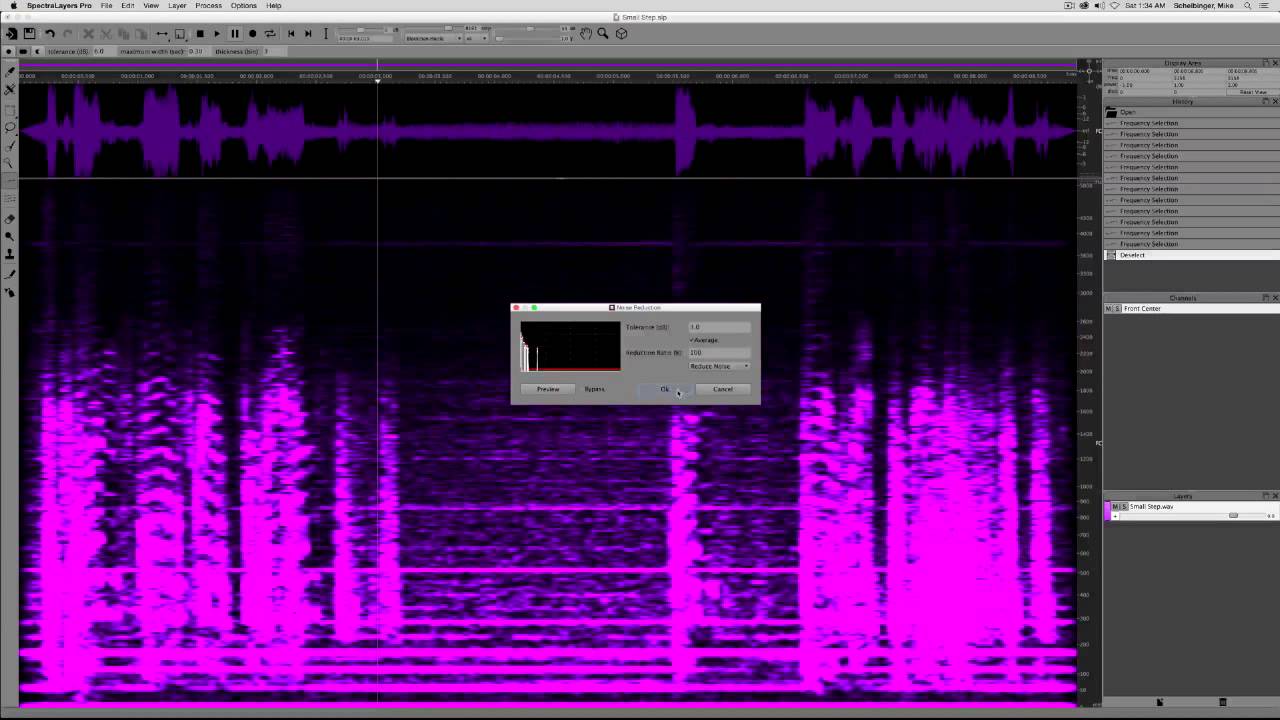

Well a program that can analyse and isolate instruments automatically no and It is highly doubtful there could be one.
However I now this one but you to do a lot manually which is not a problem and I guess you know this program:
I would definitely buy this software if I was a pro and or have 340 euros to spend on a software for regular use.
It seems there is another program by Izotope but I haven’t checked It yet.
I think I have a noise removal tool plugin with audacity with sample but if I remember it doesn’t work or is disapointing.
Do you know such a plugin that is satisfying enough ?
They know what they have.
